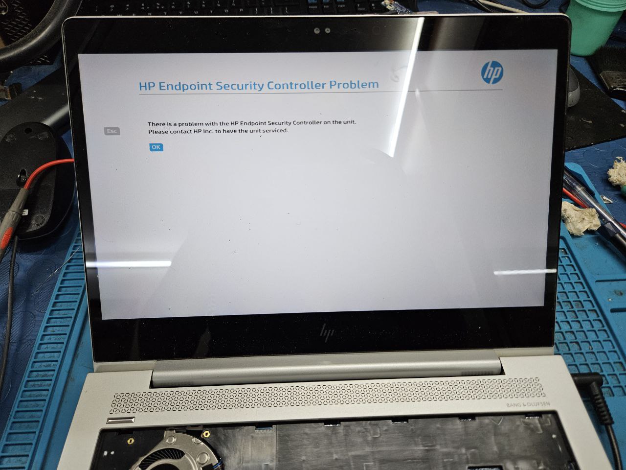

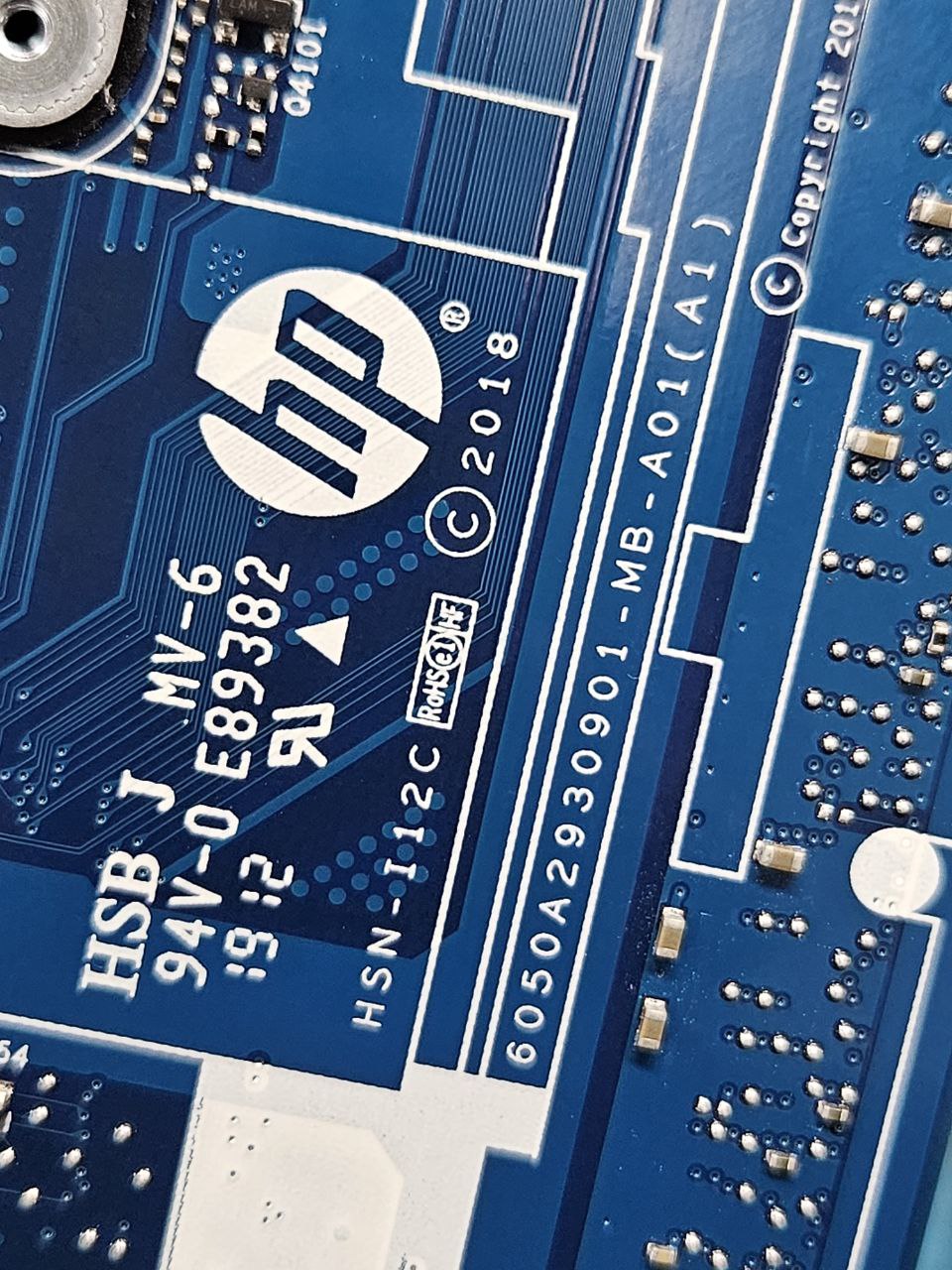

SKB ADL HP ELITEBOOK 830 G5 Q78 CSME CLEAN UNLOCK END POINT REMOVE DMI INCLUDE 6050A2930901-MB-A01 (A1) OK BIOS i5-7th

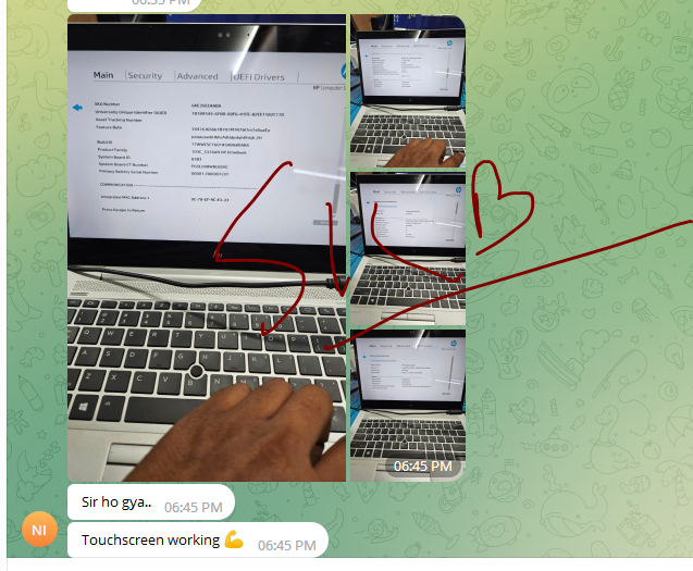

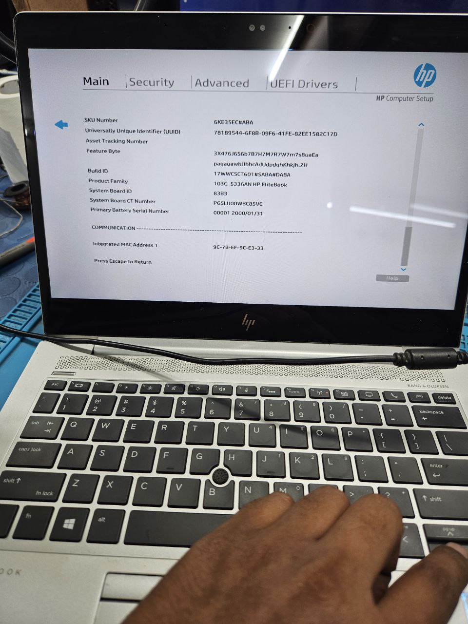

SKB ADL HP ELITEBOOK 830 G5 Q78 CSME CLEAN UNLOCK END POINT REMOVE DMI INCLUDE 6050A2930901-MB-A01 (A1) OK BIOS i5-7th TOUCH SCREEN DONE

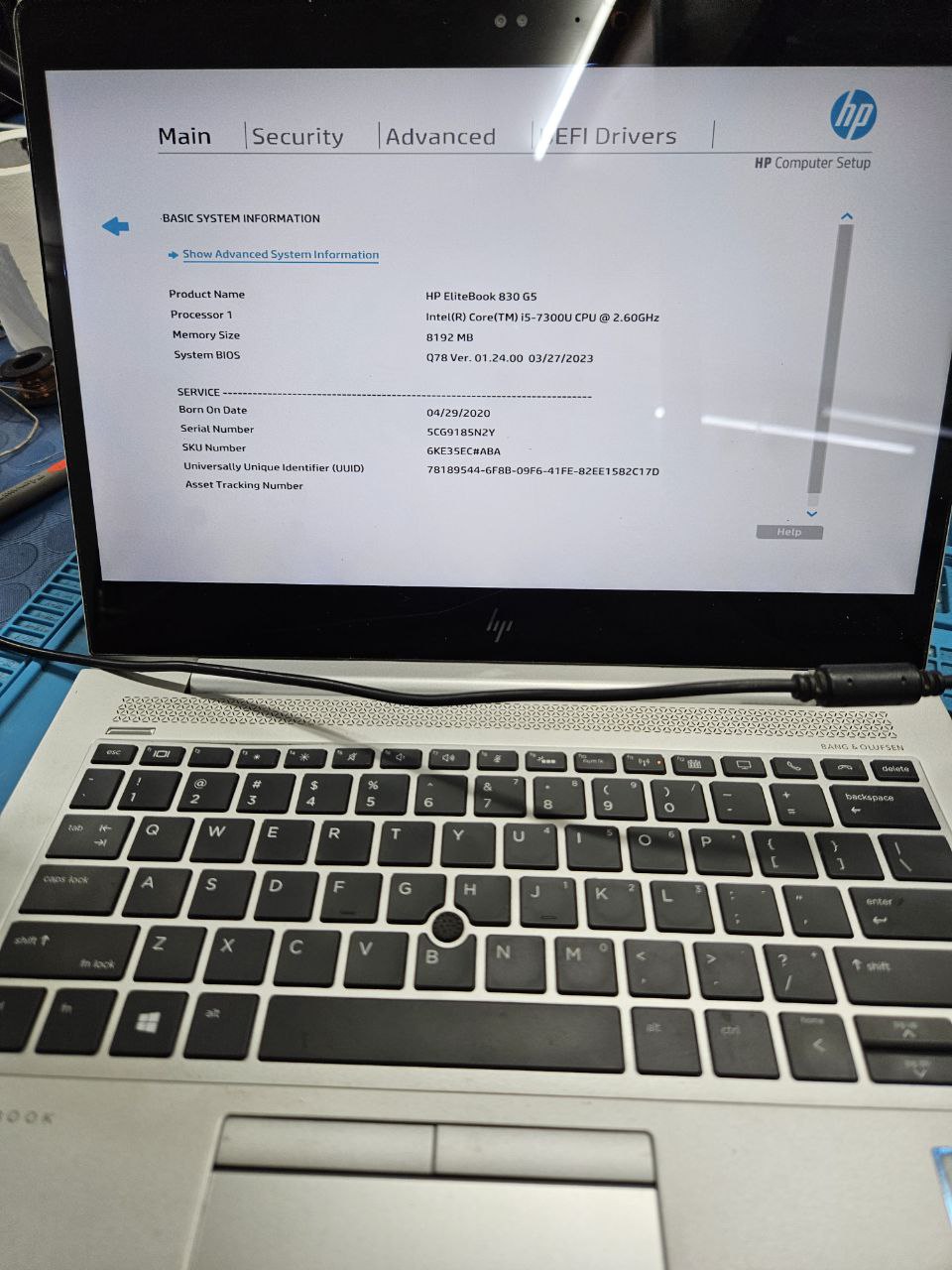

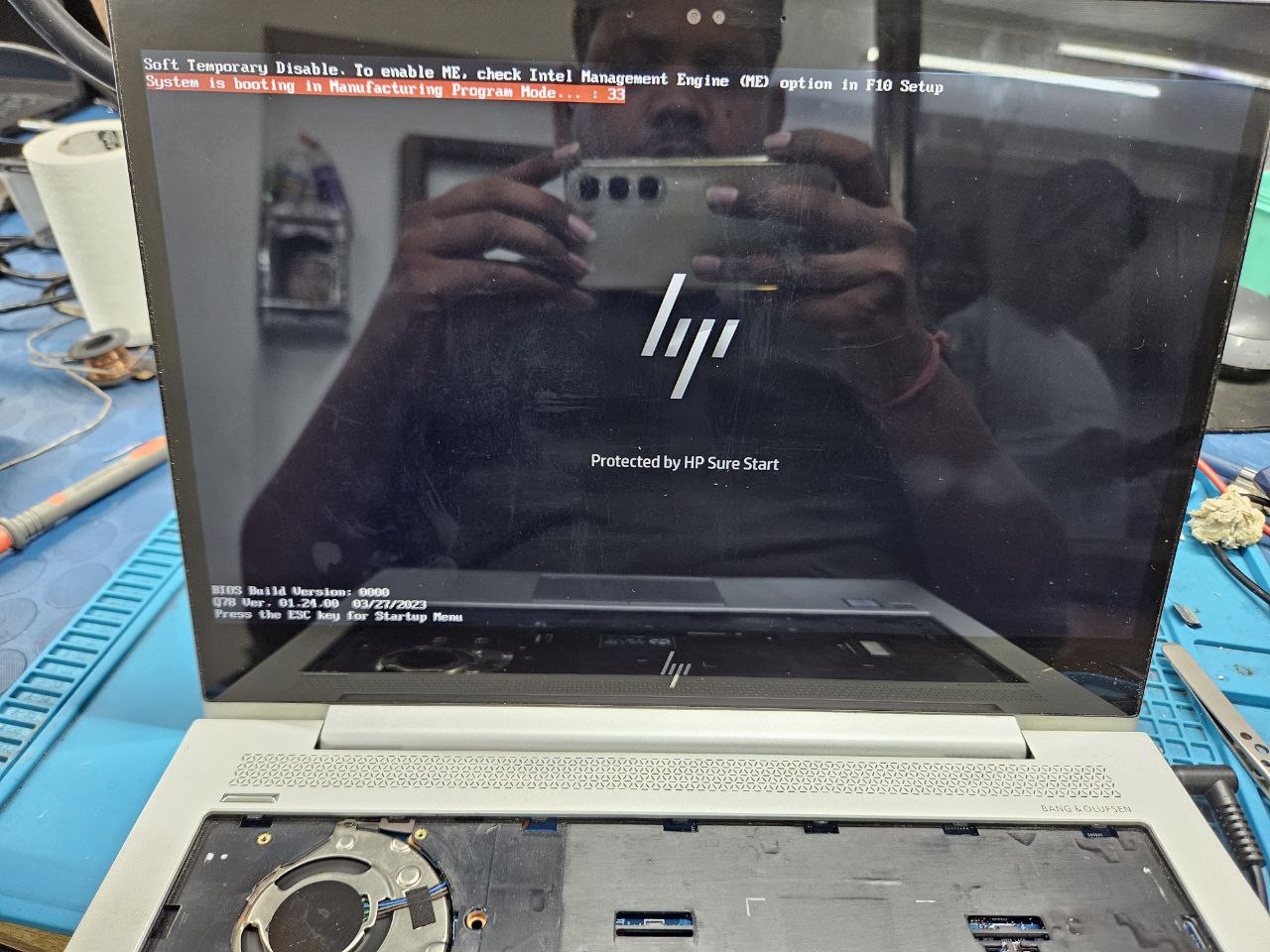

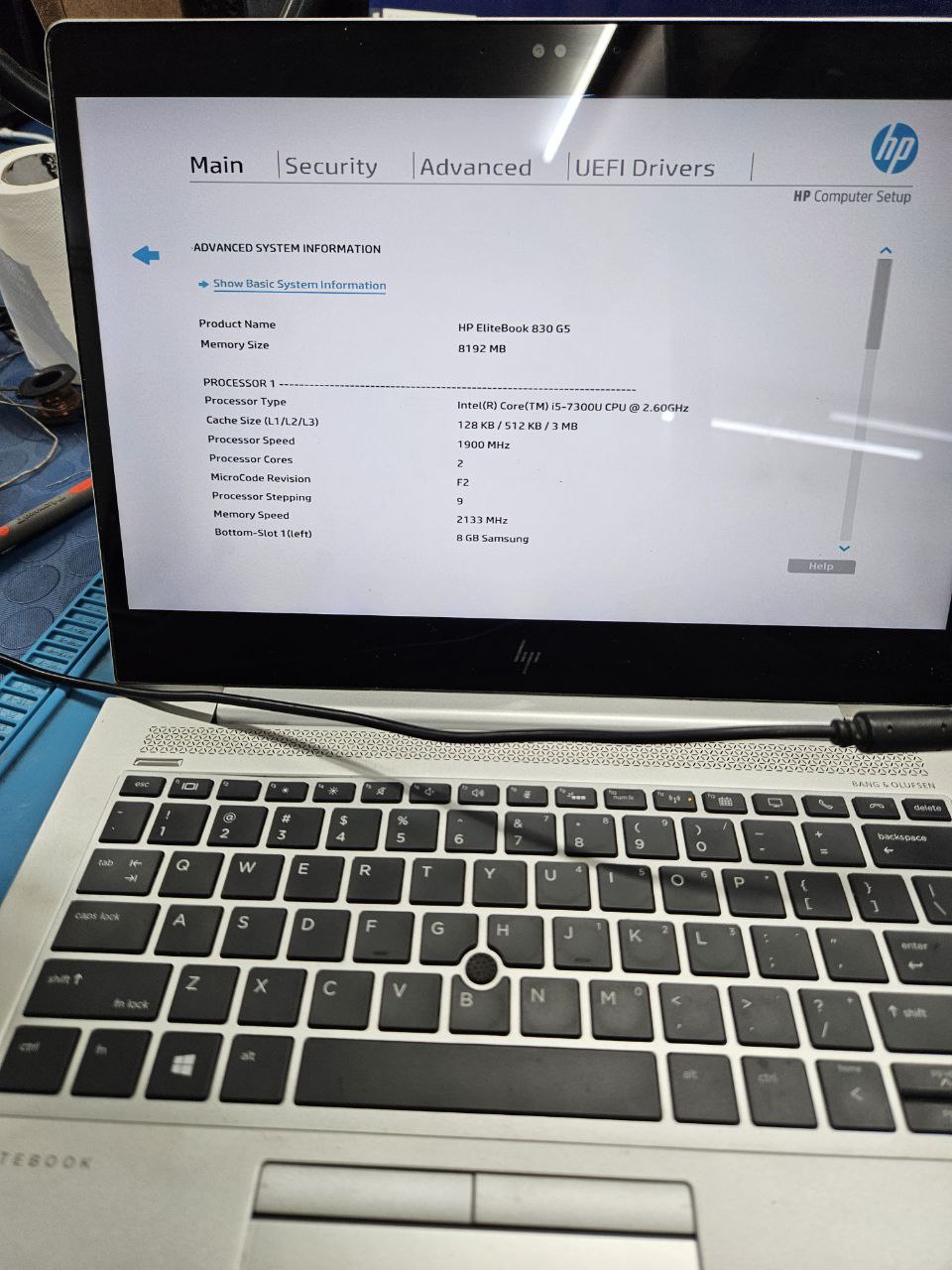

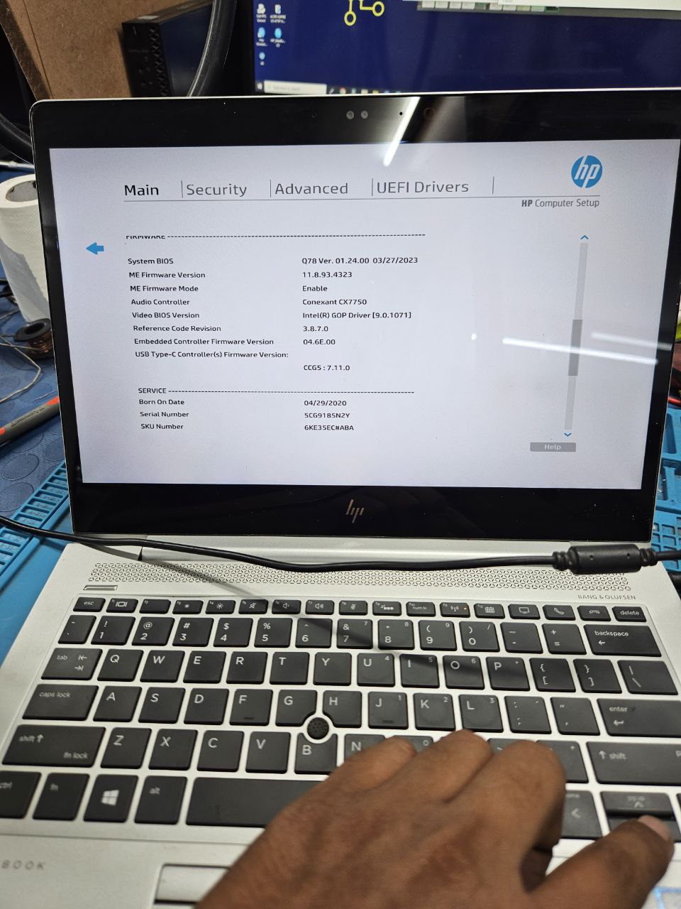

IF END POINT ERROR CAME
SIMPLE FIRST FLASH PATCH FILE
2-) in First BOOT got to SETUP
3-) in MAIN Tab RESTORE Factory DEFAULTS
4-) SAVE and EXIT
THEN FLASH OLD FILE INCLUDE IN FOLDER CSME
