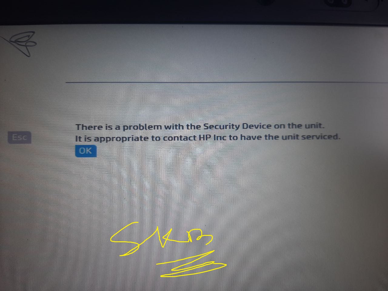

SKB ADL HP ELITEBOOK 840 G5 Q78 COMPUTRO - 6050A2945601-MB-A01 END POINT REMOVE CSME PASS UNLOCK OK TESTED DONE BIOS
Posts: 12694
1-) Flash Patched File
2-) in First BOOT got to SETUP
3-) in MAIN Tab RESTORE Factory DEFAULTS
4-) SAVE and EXIT
5-) FLASH BACK Original Bios BIN File
